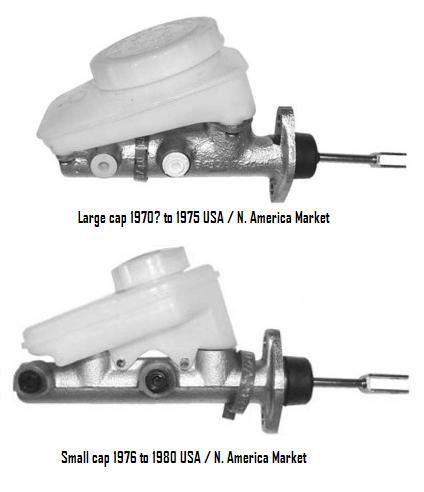

The difference between brake master cylinders is:
70? -75 large cap dual reservoir North America/USA
76-80 small cap dual reservoir North America/USA
Most everywhere else had a single reservoir, in other words the reservoir served both the front and back brakes without a seperation divider inside.
The North America version had a wall inside the master cylinder so that if the front brakes leaked out the rear would still have fluid, that is why they also have the PDWA switch.

I have, I put a small cap in place of a large cap, but while the fittings were the same I had to make a small modification to the bulkhead/firewall for the small cap as it's housing was like an extra 3/4" to 1" longer than the large cap style or something to that effect.

Hey Al, no it was the metal part which the master clinder sits on, it is longer, Triumph made the bulkhead behind it with a deeper recess starting in the '76 year model spits.

I also read that the bracket angle was different
