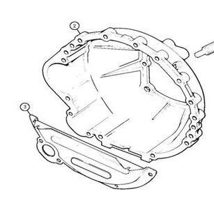

I'm a bit lost/confused regarding the install of the dirt shield into a 7 with an SD1 V8 and LT77 5-speed manual. The PO bought the wrong part, I think it's for an auto, not manual, therefore doesn't allow for the slave cylinder, and so wasn't installed at the time. I've got a correct one on order from Rimmers, but not exactly sure how to it fits - I mean, I know where it goes, and theoretically how it fits, but can't seem to find any diagrams to confirm a few things, so hoping I can get some advice.
Obviously it has 4 bolts that connect the shield to the bellhousing, but it also has two tabs at the top with holes in it, do they connect anywhere, because I can't seem to find any reference to them at all, and the TR8 workshop manual only refers to 4-bots securing the plate to the bellhousing?
And now for the really dumb question, sorry for asking and please have a good laugh at my stupidity - again, I haven't seen one installed, nor can I find any diagrams to guide me, so this is just based on gut feel. I'm hoping when the plate arrives, it'll all become clear, but right now it's not really making sense.
The dirt shield is obviously "shaped" and not flat - it has a kind of dome which goes on the engine side; but when you marry the block and the bellhousing together, the only way that my confused mind says that there's enough room for this to all go together is for the domed section to slide in between the flywheel and the engine block, although it's actually bolted to the bellhousing - is that right?
I've tried to draw a diagram to help explain - the dirt shield is the red line.

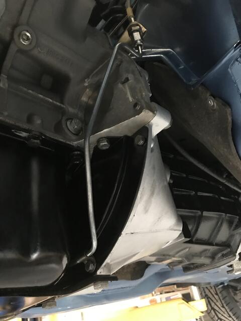

I added this piece because I forgot to install it after the engine and transmission were installed into the car.
I needed to lower the front sub-frame about 6 inches and prop the engine up by supporting it under the front pulley/damper and leaving the transmission attached to the unibody. WIth the lowered sub-frame, you can then remove the oil pan and slave cylinder to install the dust cover. So in the end, it's a fairly involved installation. Lowering the sub-frame with the steering rack attached and the pump on the engine requires some tricky loosening to gain slack on the hoses. You'll also need to free the struts from their mounting points to lower the whole assembly.

I can understand the slave removal, but I'm presuming you needed to remove the oil pan/sump to get around the stiffening plate?

LaVerne - brilliant, thanks for the photos - yes they do help - so those two upper tabs actually connect to the block - now I just need to figure out those bolt sizes LOL

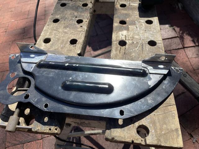

So to finish this thread off, I've finally got the damn shield sorted out. As Pete said, above, the Rimmer's unit was too tall and the bolts connecting to the block were in the wrong position - I did provide some feedback to their customer service email, but (kind of) as expected, not even so much a "thank you for contacting us...." reply. However, it is what it is...
Anyway last weekend, after several attempts to enlarge holes, I did actually get the plate to fit , kind of, but wasn't happy with those stupid little tabs on the top connecting it to the block, as they didn't really hold it in place - every time you breathed the damn thing fell off/came loose. So I bit the bullet - fabricated up two new tabs out of some square tube, took an angle grinder and cut the plate, just under the top lip and tabs. Then slipped the bastardized plate it into place, but not bolted, connected up the bellhousing, bolted the plate to the bell housing, then bolted the tabs to the block, epoxy-ed the tabs to the plate, and left it.
Today, I disconnected the bellhousing, took the plate out, with the tabs still glued in place, they did need a bit of extra grinding down for clearance, and welded them up, then sprayed with engine enamel. Apart from the pigeon poo welding - I'd bought a MIG which I'd never used before (had a stick/ARC previously and was pretty crap with that as well
) - I think overall it came out all right, and it fits perfectly. Very happy. Now on to the next challenge....
