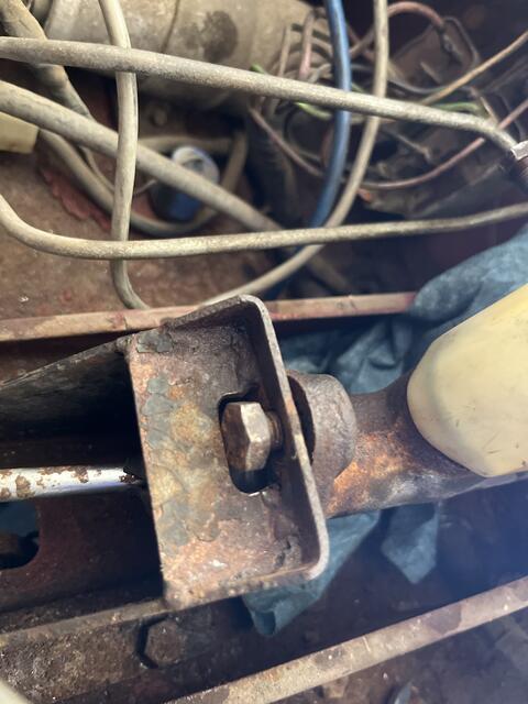

It appears that someone installed the top bolt on my master brake cylinder backwards, so I can’t take it out. I physically cannot get the bolt out no matter how much i try. Any suggestions?

In reply to # 1924385 by Mroogs It appears that someone installed the top bolt on my master brake cylinder backwards, so I can’t take it out. I physically cannot get the bolt out no matter how much i try. Any suggestions?
Pull the bracket off of the car (4 bolts) and then remove the bottom bolt. That will allow the cylinder to move forward enough to remove that captive bolt, which is by design.

Well, that makes a lot more sense. Thanks lol

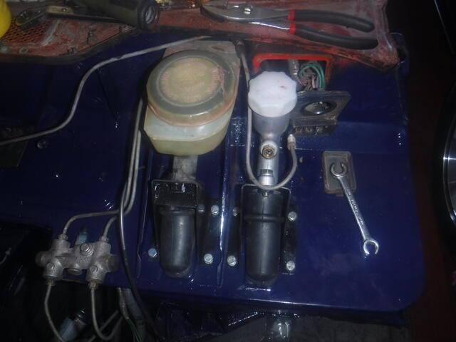

Yes I just installed brake and clutch Masters as long as you do not remove the backing plate and just run a tap to clean threads before replacing same all good. I also remounted with SS 1/4 x 28 bolts
