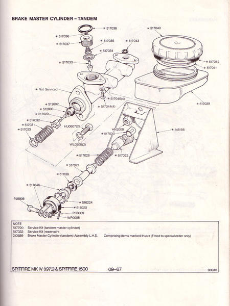

The older models have something called a tipping valve that needs to be removed. It unscrew from one of the openings into the master.
master.jpg    40.8 KB
master2.jpg    38.7 KB
Falkon Avatar
Falkon Al Martin
Appleton, WI, USA   USA

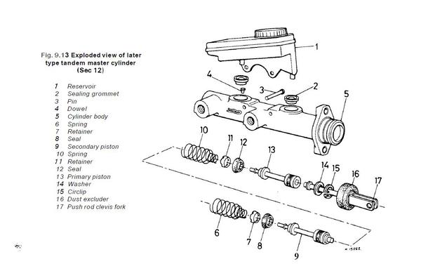

Here's a newer one.
MasterBrake.jpg    27.6 KB
76spitspin Avatar
76spitspin John Erickson
Tolland, CT, USA   USA
I just did mine, used an airgun as Dan had described. I found that the sealing gromets that cam with my V.B. kit, (2 in the diagram, didn't fit, so I flipped them upside down and it works fine. Just a heads up.

In Al's last picture use a pair of needlenose pliers to pull out the little Dowel, which is the #4 in the picture. You might have to put a screwdriver and push the piston back a little, the you can pull out the dowel.

I found that the grommet/seals as shown in the diagram (with the wider part at the top) is probably right. I don't remember which way they were before I pulled the old ones out (shame on me for not being more observant), and although the reservoir did fit into the grommets, it (the reservoir) fit MUCH more snugly with the wider part at the top...it sort of 'snapped' in.
