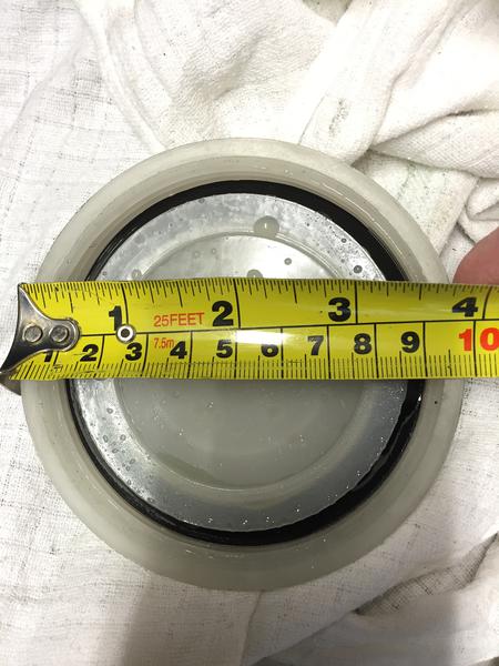

There is a definite small leak at the underneath of the cap, The rest of the cylinder looks fine. The reservoir is not over filled. I've attached a photo of the cap and the only seal it has, there is also no vent hole.

David , What your describing is identical to my issue. Finding brake fluid, what appears to be leaking just under the cap. I recently purchased a new rubber seal for under the cap. I am not totally convinced that it solved the problem. Has helped a bit. Not really keeping a eye on it , I have the drip trays installed.
If you look close I think you will find a very small hole on top of the cap. This is where I believe its coming from and flowing over the cap edges.
Its a mystery .
I even made a cork gasket and added it to the rubber gasket, no improvement
