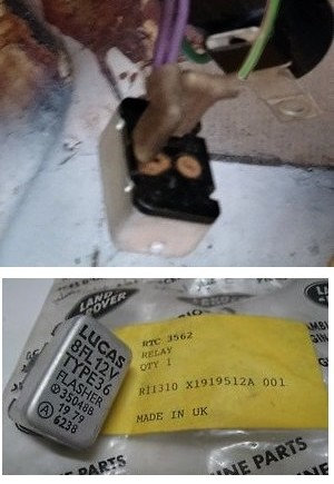

@ jb4249
your two sons, purple and green, connect to the turn signal unit
view the photo
friendly
Olivier

That's a great help, thanks. The flasher unit in the glove box turns out to be the hazard flasher unit. I found the turn signal flasher unit in the driver side foot well. But putting the hazard unit in provides power to the hazard switch which in turn powers the turn signals. I've managed to get that power cut through to the TS switch and still no turn signals, but I have found that the TS switch has been replaced before. The wires are connected with wire nuts that I am going to replace with soldiered connects. From there I can also test the TS switch to see if it is operating correctly.
