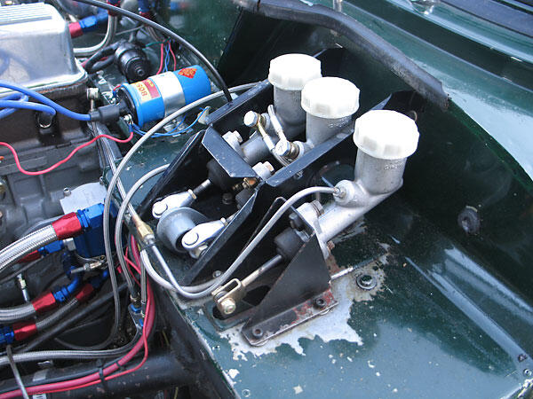

In reply to # 1730729 by 14GPDJENGINEERING Here is the design I stole from Rick Cline -- crude but it works. I sleeved two OE 5/8 master cylinders with some stainless steel tube I had.
Dennis,
I have been toying with that idea for years. What size did you sleeve down to and where did you get seals for them?
Curious,
Paul
I bored out to fit 5/8 ID thin wall tube so still used OE seals.
The pivot hole was welded up and re-drilled about 1/4 inch lower to reduce pedal force.
Dennis smiling smiley

Dennis,
Just the way I've been thinking of doing the mod. I have one old brake master that needs a sleeve. And a pedal bracket that has been modded to move the pivot closer to the cylinders. Looks like I'm well on the way.
Thanks,
Paul

Paul, here is another image I found.
