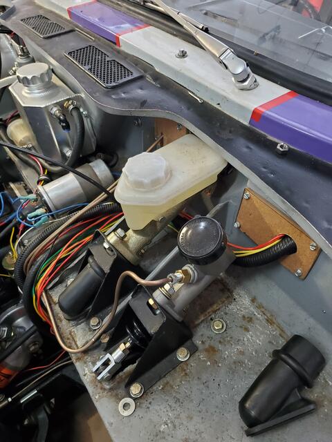

Thomas: you can replace what you have with a dual master cylinder. I replaced my original MC and PDWA during rebuilding with one using a new one from a Spitfire 1500
Replace the MC, and remove the PDWA. Pipe accordingly. The fire wall will probability need some modification to accumulate the extra length
very doable and a good upgrade.
