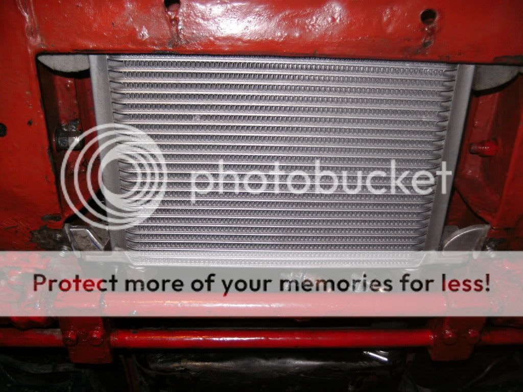

Mine is under the radiator between the frame.
Surprise, it isn't for oil . . . but it is an oil cooler.

In reply to # 1350946 by Dickie B Mine is under the radiator between the frame.
OK, so what is it then?
Carter, he put in a fuel cooler, to help with vapor lock issues. There are threads somewhere on it.

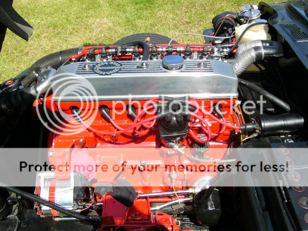

No one seems to have mentioned it, but, go for the biggest fitting ye can get, IF no going for plumbing fittings
reason, the holes int unions are alot lot smaller than the pipes, so doo mek a restriction to flow
A 1/2 BSP is not 1/2 internal bore ont fittings
but a 1/2 inch plumbing pipe is 1/2 inch, follow,!!
Here is acouple of solutions, both too location, and hoses. I had a water cooled cooler, worked great for 25 odd years till the thing cracked, beed to logged to see this type.
but put this,n in the same spot, it works great
pipes, alott moer compact than the great big hoses.
mebee of some intrest to some
