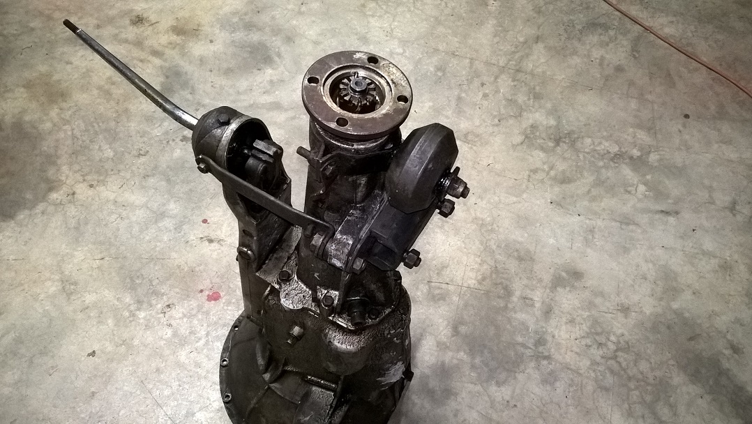

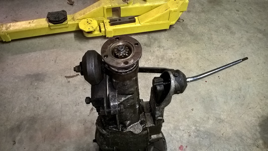

I bought this transmission yesterday and I am baffled by the rubber insulator on the tail piece. It looks like it was probably used as an exhaust hanger. It also looks "factory" but AFAIK it doesn't belong on a TR. I was told the transmission came from a TR4A. Anybody know it's origin/application?

It’s an anti vibration device, have one on my 62 OD TR4. None of the 4as had one, but they are all 4 speeds.

In reply to # 1503979 by Perdido Dan,
Rut
Still don't get it. What does it bolt to and why is it needed? Every TR I have owned except the current one had OD and I don't recall ever seeing something like this. I also don't see it in any parts manual.
Dan

Dan,
I just hangs off the tranny...mine was the first and only one I’ve seen.

It was only fitted to a fairly small range of cars; I've also got one in a parts bin somewhere. It is mentioned in the SPC, more than once IIRC.
EDIT: Here are the two SPC entries, TR4 and TR4A

along with PCV it's probably the most useless add-on i've come across on a TR

Thanks - an interesting bit of lore. I can't find that in my copy of the SPC (20 TR 4, First Edition). What page and/or plate is it on? Not that it matters - based on the discussion here it's going into my parts bin as well....

I have an early '63 TR4 with an overdrive A-Type transmission with the damper on it. I put it back on when I rebuilt the tranny and the transmission is very smooth. It came on the tranny so, I left it on the tranny. "If it's not broken, don't fix it."
