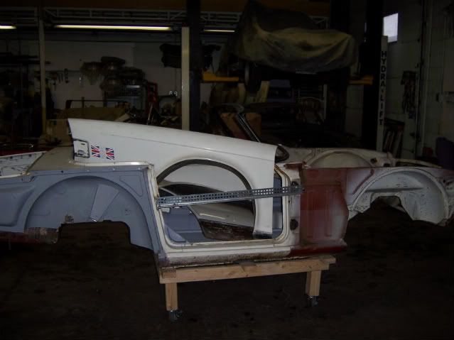

You are moving along. I see that you left the doors on (to keep body from shifting). I made door opening braces for mine. One end bolts to the B post where the door hatch is and other end to the upper door hinge bolt pattern. Also makes for a good lifting point. Can send you pictures if interested.

I was probably getting a little lazy so I left the doors on instead. I have the bars that I used for my TR6 kicking around and will install them if need be when I am shifting the body. The bolt to the A and B pillars using stock locations as well and are easily attached/ removed.
Here's a quick pic of it installed on my TR6.

That will work. Made mine out of 2" sq tubing with plates welded on each end. Overkill but I had materials on hand. Worked out good for using to lift with them. Have a rust free 4a to do next but its good enough I am not doing frame off on it. Your frame looked pretty good in poctures.
