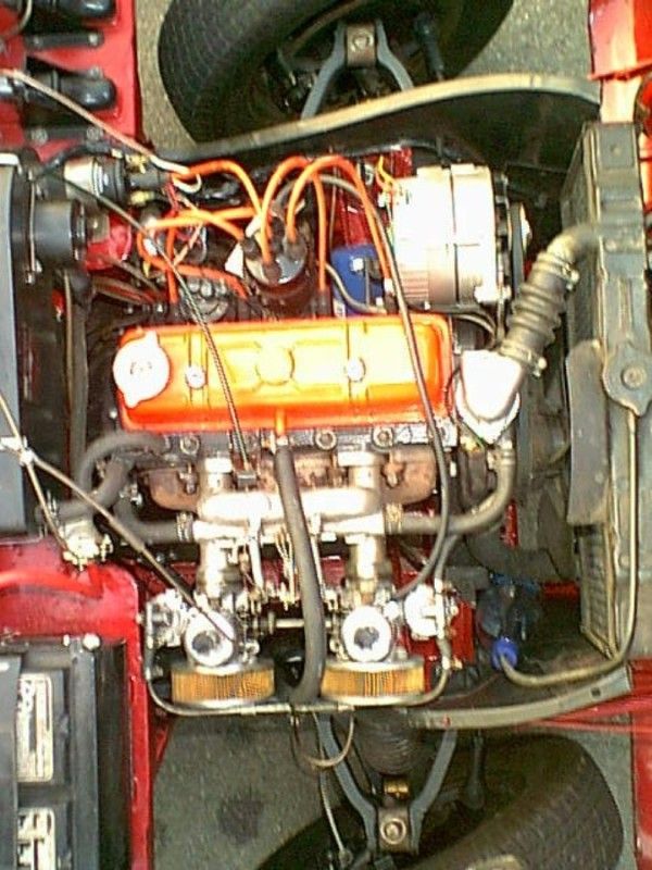

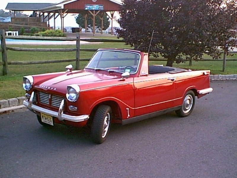

Way back when(1990s), I restored (formerly) my 1964 Herald 1200, and put in a Spitfire III camshaft, and dual side-draft SUs from a Mk 1. Spitfire, while maintaining the original single Solex head... That was something: The dual carb head has SMALLER intake valves than the single carb head: By combining the dual carbs & the larger valves, I got some great performance! I used to BURY the speedometer needle- It would go past its highest marks by a little ways... Which was neat... Andy Mace can tell you about that car- she was a sweet runner, and was just like a brand new car when I got finished with her. I also upgraded to a GM single wire alternator, and custom made my own mountings, using the original genny mounts as hard points. If you click on any of the pics below, they will take you to my Photobucket page for the Herald- feel free to roam through- you may get some ideas...
I sold her a number of years ago to Bill Goodwin in Maryland, who takes her on things like the British Reliability Run etc... She does well, I understand- Hemmings even mentioned her in an article on the run a few years back- Apparently the author was in a Spitfire group she was at the front of- and all the Spit drivers thought they would be stuck behind "another slow Herald"... She walked away from them! smiling smiley She is known by the name "Britwit" last I heard. And I'm driving a TR6 these days, though I always have a warm spot for Heralds...

In reply to # 1437152 by ng19delta Way back when(1990s), I restored (formerly) my 1964 Herald 1200, and put in a Spitfire III camshaft, and dual side-draft SUs from a Mk 1. Spitfire, while maintaining the original single Solex head... That was something: The dual carb head has SMALLER intake valves than the single carb head: By combining the dual carbs & the larger valves, I got some great performance! I used to BURY the speedometer needle- It would go past its highest marks by a little ways... Which was neat... Andy Mace can tell you about that car- she was a sweet runner, and was just like a brand new car when I got finished with her....
I sold her a number of years ago to Bill Goodwin in Maryland...
Definitely a sweet runner of a car! thumbs up
Sadly, Bill Goodwin passed away in September 2015. I believe, at this point, the car is still with his widow Carol. I know that there are many fellow Triumph enthusiasts in that area who have been helping her out; one way or another, I'm sure that Herald and his other cars are in good hands and being well cared for.

Thanks Andy- I did not know Bill passed away; I only met him during the sale of the Herald, and he seemed like a real nice guy... He was working on getting one of each Herald type, and was delighted with mine as the convertible... Thanks for the update. If I had the funds, I'd probably make her an offer for the Herald, but I'm sure if she is interested in doing so, she'll find her a good home, if she hasn't done so already...

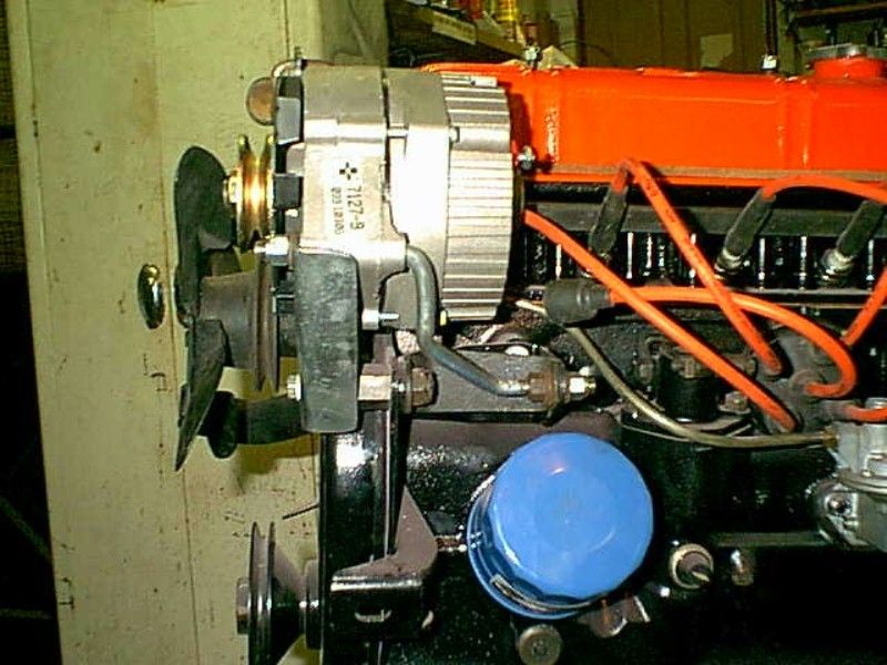

Thanks Scott, the car looks great but it's sad to hear about the owners passing. Maybe my frame of reference is wrong then because that looks like the Mk2 intake. I have been contemplating a switch to an alternator, but the generator was re-cored 4 years ago, so it's probably worth spending the money elsewhere for right now. When you replaced the valves you also modified the head?

In reply to # 1437397 by Herald LA Maybe my frame of reference is wrong then because that looks like the Mk2 intake.
You are correct! The early Spitfire 4 intake is easily distinguished by its bolt-on bridge/balance pipe.

In reply to # 1437481 by Herald948
I seem to recall you are correct: I removed it how many years ago from a junkyard queen...
