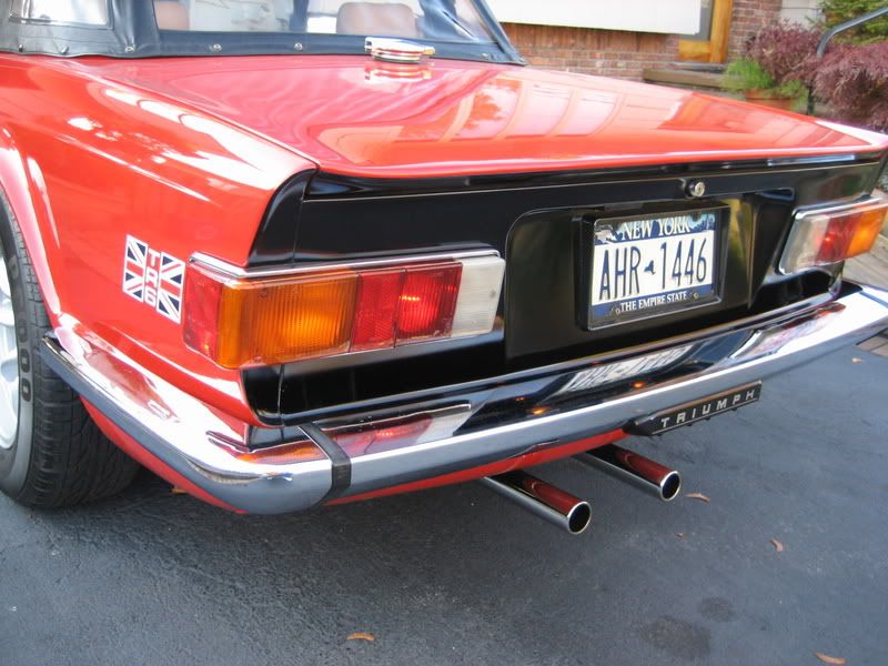

I just removed the front rubber overiders; easy and I like the cleaner look of the whole front. I want to do the same with the back but at first glance it seems a bit more complicated. It looks like when the steel structure of the overider is removed, I'll have to insert a spacer to fill the gap, right? How does the rear bumper look when the overider is removed? Any pictures of the back?

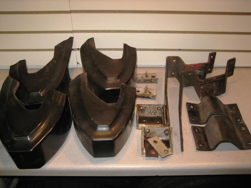

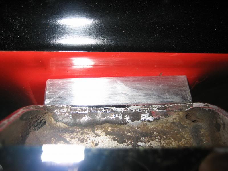

The rear bracing is more involved. My recal isn't that clear as this was a while ago but I remember removing the entire bumper. I used a 1/2" piece of aluminum billet as a spacer.

Thanks Mitch,
Your car looks good! No holes to fill on the bumpers? Did you have to remove the rear bumper?

Good move to remove the bumper guards, front and back. I removed mine form a 76 about 2 years ago and have been delighted with the look and weight reduction. I am guessing about 50 lbs total reduction. Did you weigh the removal, just curious.
Trboost Avatar
Trboost Mitch Seff
Ny, Oceanside, USA   USA
If I remember correctly the rear alone, bumber and hardware were about 35 lbs. Your probably correct at 50lbs front and rear. The front used much less hardware than the rear.

I have a 75 and removed the overriders during winter. The rear will actually slide forward half an inch so no need for any spacers. There are sliding captive nuts in the side sections. Some earlier models have a notch cut out of the bumper to allow for the overrider but my 75 year model does not.
