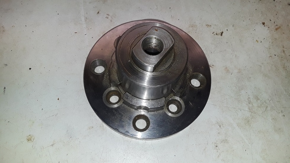

Thank you for your input. After giving it some more thought I am going to have another look at a "universal" design - this time using interchangeable centers to avoid the interference issues. I think all I need do is make an additional center for the one I just finished and add 3-3/4" bolt circle holes to the outer ring. Hopefully I will have something more for show and tell shortly.

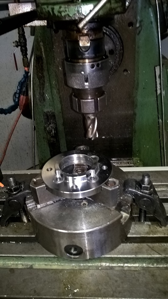

One Ring To Rule Them All
My thoughts exactly and it was easier than I anticipated. It even passes my aesthetics test cool smiley
As you can see from the tiny bridge left after cutting the relief there is just enough room to get an 11/16th socket on the Spit lug nut. I still have to add a very small relief for the TR lug nuts, countersink all the holes, mill a couple flats on the top for a wrench, and do some deburring/polishing and it should be good to go.
Jim, I'll give you a call in a little bit. That shed wouldn't happen to belong to Roger Worthington would it? Speaking of which I wonder if Roger or one of his mechanics would be interested in one......
Dan

Well I have good news and bad news.
Good is I finished the puller and gave it another test on the untouched hub of my TR4. This one was bear and required a couple 3 foot long pipes but the puller did its job perfectly.
Bad news is that when the hub broke loose with a big bang I fell sideways and broke my ankle.

Just got back from the E room and I am happy to report they tell me it is a cracked tibia and no surgery needed. I am hobbling around with crutches and a splint for now. Go to see the bone doc ASAP for a more detailed evaluation. This is going to put a major crimp in my shop time.
I can tell you I had the puller cranked up really tight - three foot cheater and my full weight on the end. When it let go it was LOUD. I see why these things have the reputation the do. I didn't get a chance to make a full exam but I think the puller came through unscathed. No so the old hokie. I will survive and hopefully be mobile enough to get back on the horse in a couple weeks
