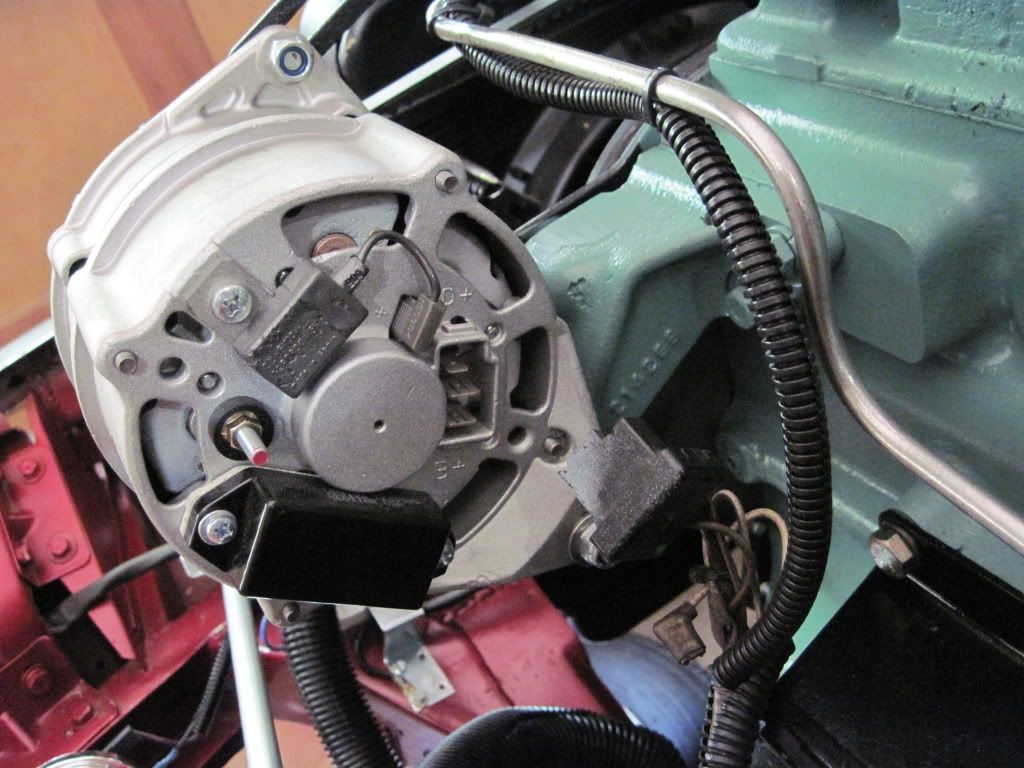

I bought a GM Delco from Summit auto cost me $95.00 a number of years ago very easy swap and still kicking.grinning smiley
IMG_0148.JPG    60.3 KB
