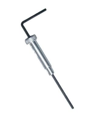

There is a special tool that yo need to order that allows you to adjust the needle fromt top. Has it always run lean? Are yo sure there is enough fuel getting to the carb? Just my 2 cents...make sure that everything else is working before adjusting the mixture.

You can adjust the mixture with an Allen key. 1/8 inch I think. Remove the dampner from the top. You have to hold the air valve with your finger so it doesn't turn also.

The ZS tool is critical for dialing in the mixture. You can use an allen wrench, but you'd have to remove the vacuum bell to make the adjustment. With this tool, it is done with the bell on.

Can anyone tell me where to buy the adjustment tool. I saw it once someplace but cannot find it again.

Everybody has that tool:
BPNW
SpitBits (Item #33)
TRF (Item CAT1)
Rimmer Bros.
James Paddock, Ltd.

I just leaned out my carb as my plugs were mighty sooty. I got the tool and was surprised how much I had to back it off to stop the soot from forming on the plugs. I have no idea what was going in the PO's head cuz it was so rich running. I am going to run it for a few days after work and see how things seem, but so far things are much better.
