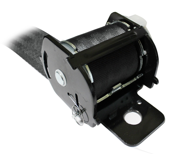

Confusion in terminology! Dave refers to having NO retractors on his original 1970 lap belts. Federal law at that time required belts to be installed, but I'm pretty sure Triumph did that either at Port of Entry or at some point on the route to the regional distributor or final selling dealer. Actually, the belts likely were actually installed by the dealer, since it was a simple matter of fastening the ends to the eye bolts already in the floor. Anyway, some of those belts did have the little chrome retractors, possibly also a plastic "sleeve" as well:
These simply helped coil up the male part of the belt when not in use, and one had to pull that part all the way out and then adjust the belt with the buckle side.
Meanwhile, what I casually refer to as the inertia reel part is also commonly called a retractor, and it works more like belts we're used to in modern cars: they allow some movement but lock on sudden deceleration / impact. That would look a bit more like this:
I thought I remembered 1972 models has having the lap/shoulder combination with inertia reel, but it's been a long time since I've had a '72!
