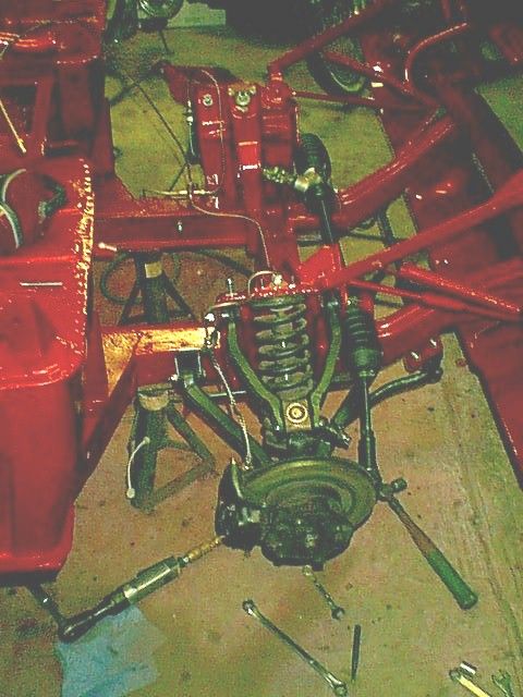

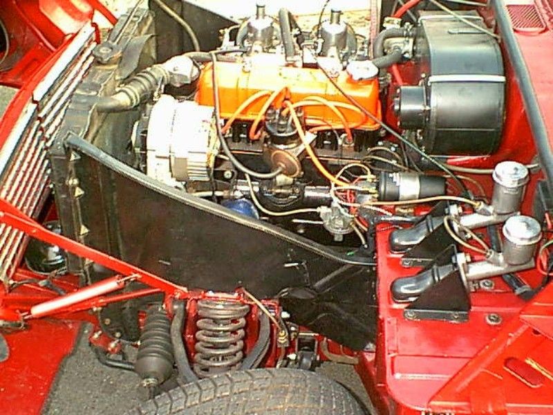

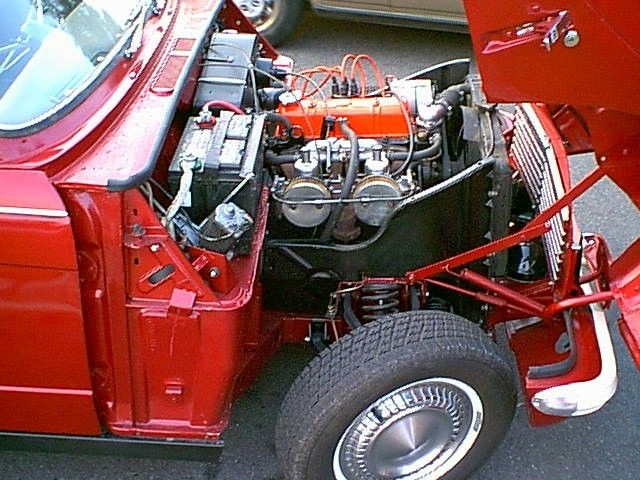

Here's a couple pics from when I put together my Herald years ago: I converted to the Spitfire discs at that time, and everything was new...(If you click onthe link, you can go through my album on Photobucket, and see lots of neat Herald details which may help...)
