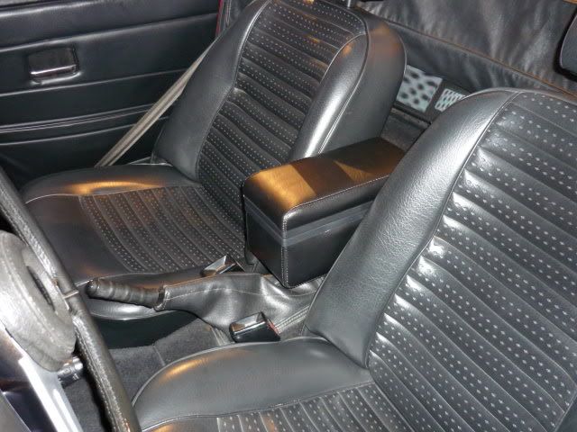

My 1976 TR6 does not have the center console your does Douglas.
What gives?

You can order them from here; http://www.triumphconsoles.com/

The arm rest is a portable one that I ordered through JC Whitney for $49.00 in 2011.
It is great for that extra storage, it was inexpensive, it installed in seconds,
and best of all it looks great.
I checked there site and I am sorry, but it is no longer available.

Yikes, that link's console was $265.
Here's one for $150 http://www.spitfireoptions.com/ProductA.html
