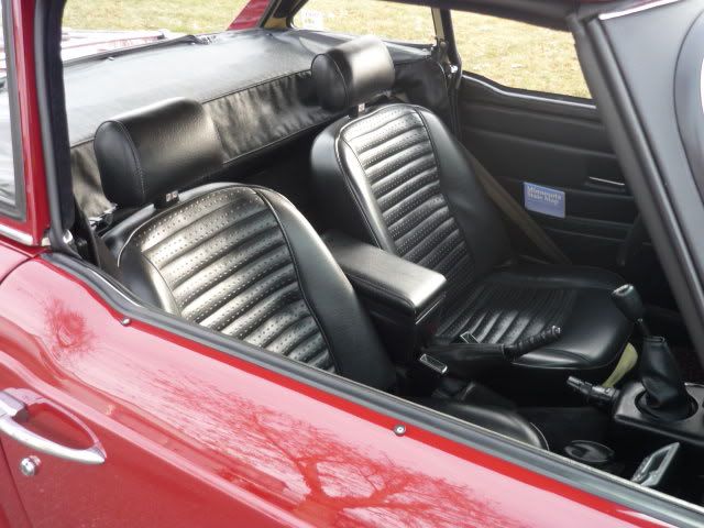

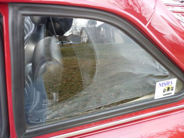

Looks like this installed

This picture seems to show the soft top still installed, (but folded). The video I watched removed the soft top mechanism prior to installing the hard top; can I assume from that picture that it's possible to have both on the car simultaneously?

Yes, it's a bit of fiddling around to tuck the top down like normal, and the bar that attaches the top to the rear deck is a little difficult to tuck down properly. Then you just snap the special hard top boot cover in place. First time for me was about an hour process.
